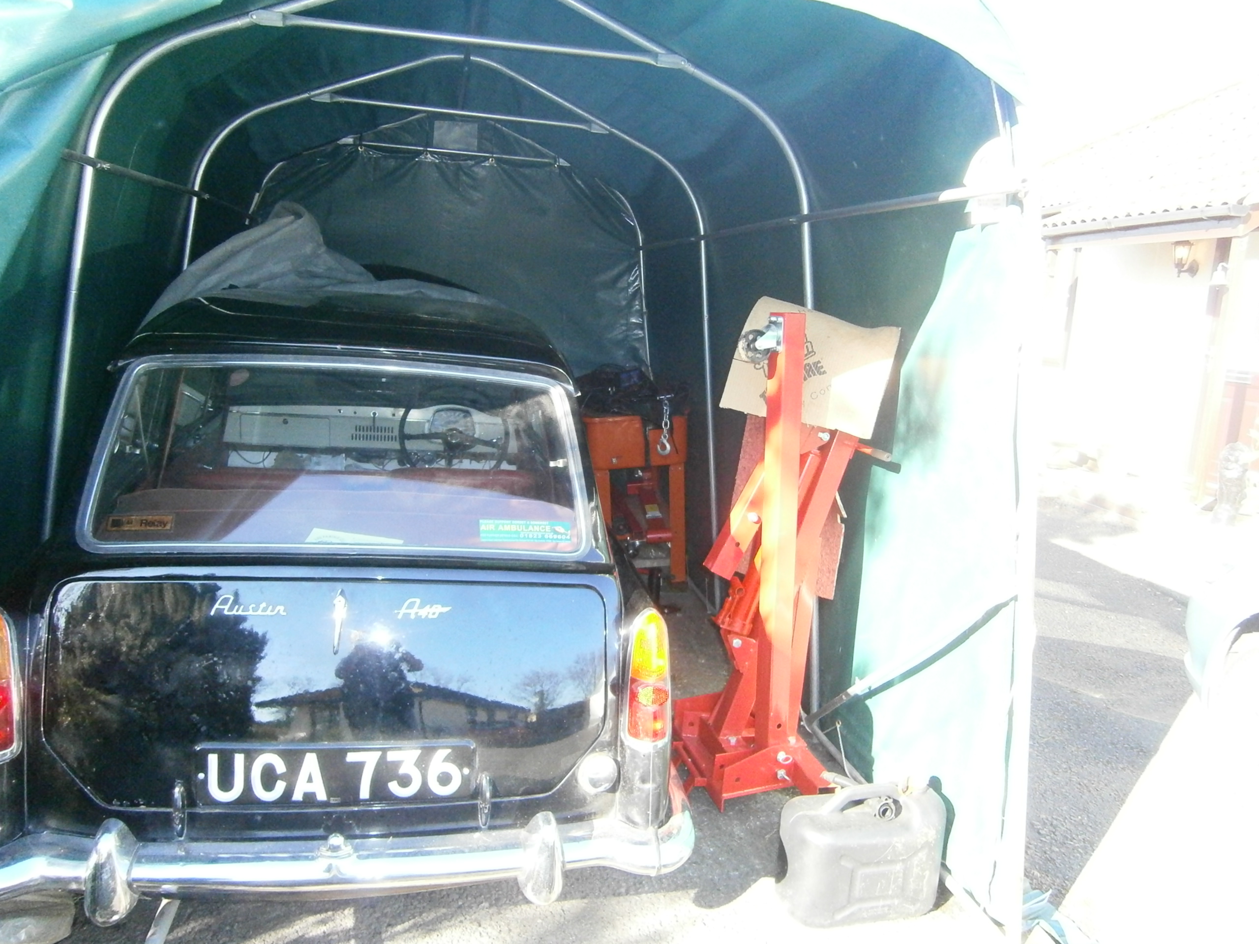

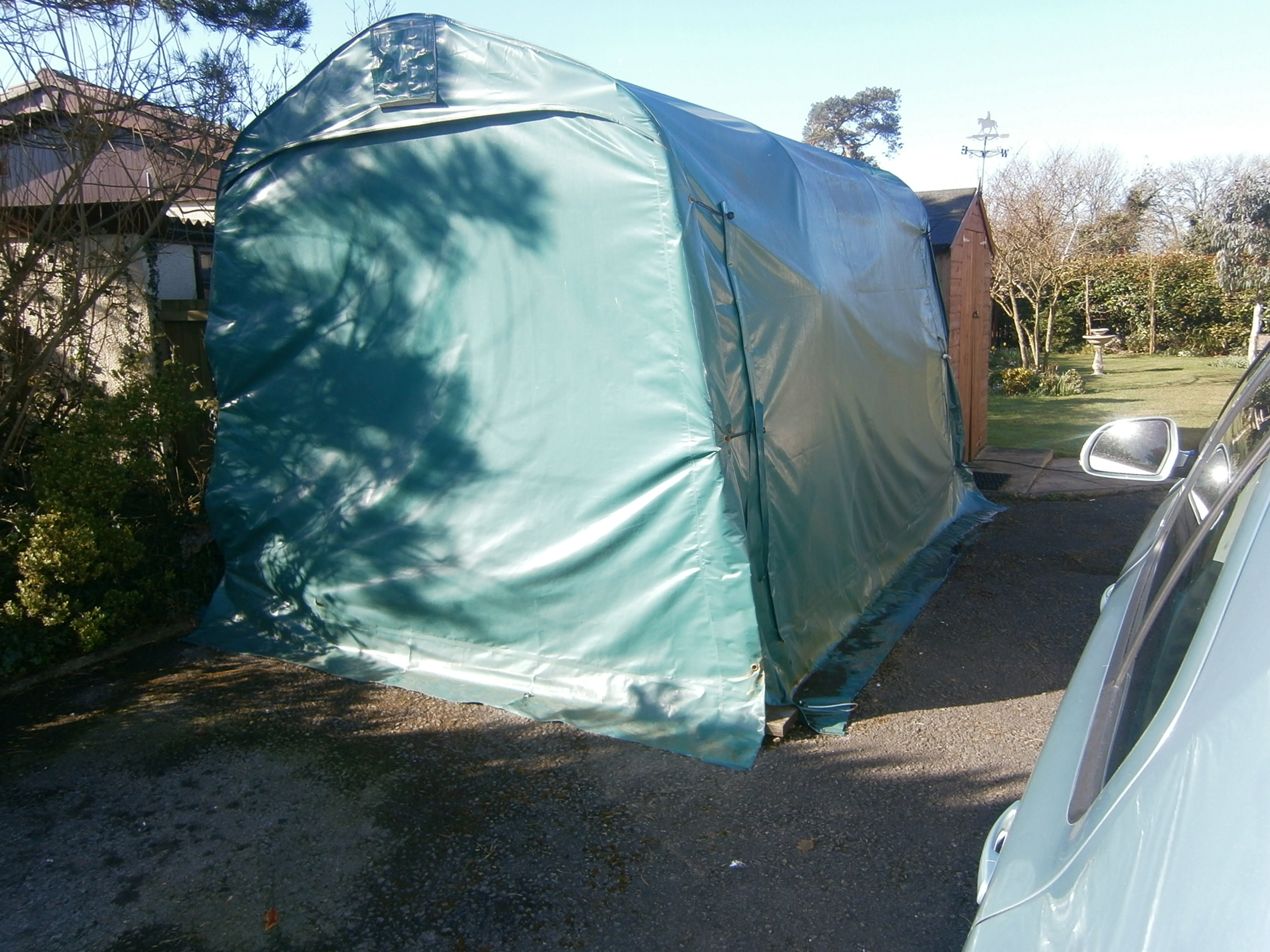

I had a Dancover for some time ,just long enough to take an A40 and plenty of width to allow you to drive in and open door .Mine was on hard standing so ground anchors were not possible but i worked out a system where the car was the main anchor.

Looks like a good set up Mike, Have you still got both cars. Both the cars look really nice.

Errr, "both" cars are the "same" car Samuel :D 8-)
