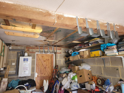

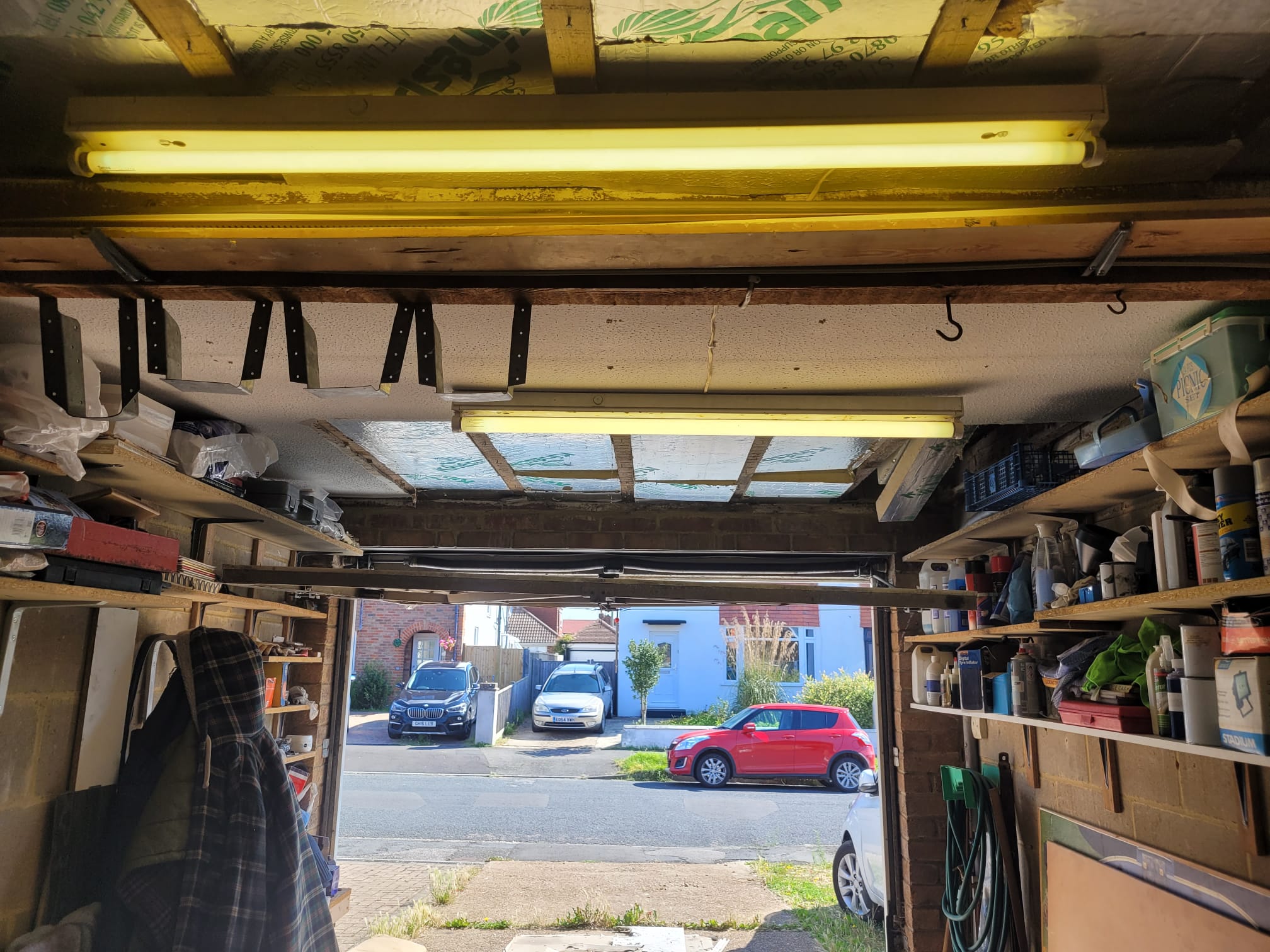

Hi all. The garage ceiling here at home is now In a poor shape. It is a felt flat roof. On the inside it currently has insulation and then pasterboard over that. The plasterboard is now in poor shape due to leaks in the past.
I'm going to be getting the felt roof checked as that is getting on now.
My question to you all is what do I do about the inside of the roof. Do I keep the insulation and pastardboard idea. Have insulation and plywood?
Or do i do away with both and just have normal roof rafters like I know many people do.
What does everyone else do with regards to there garages?
As you can imagine I don't want the garage to be horrible and damp. That won't help Ruby now.
