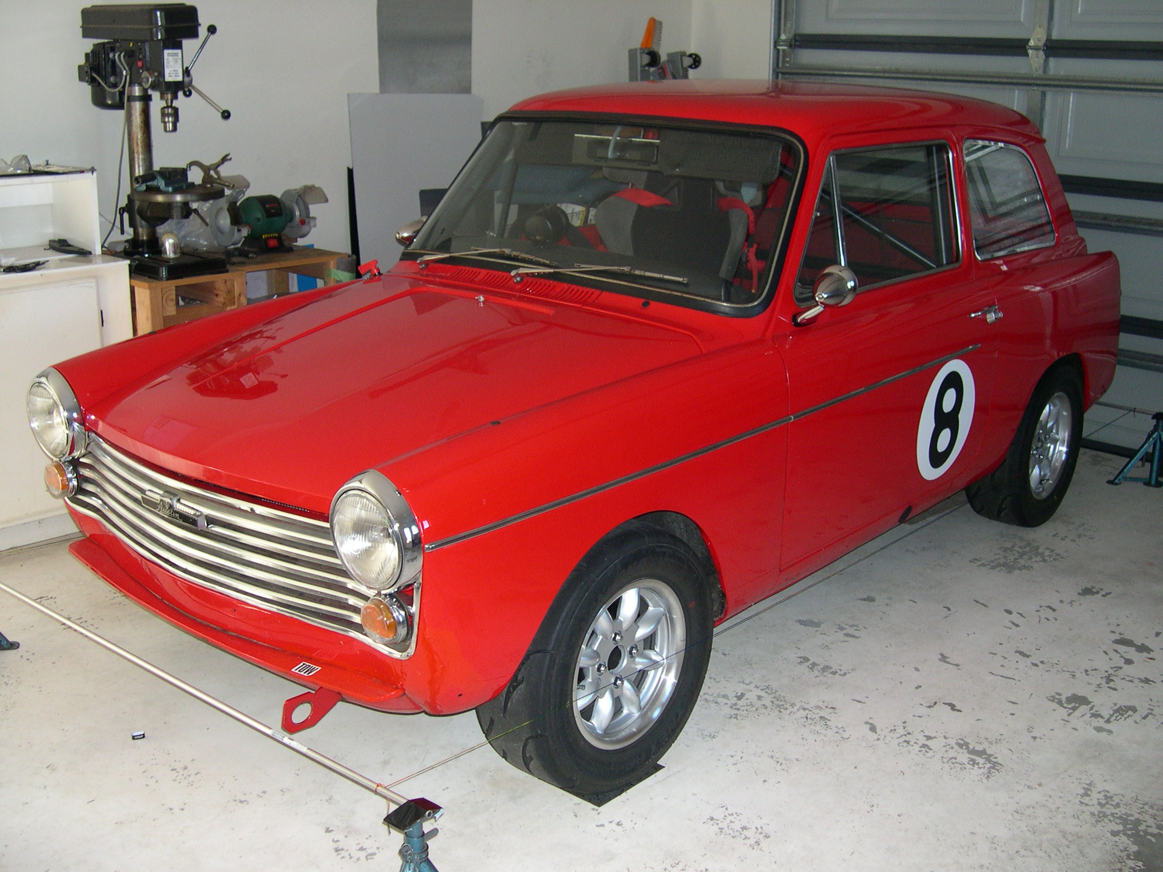

How much toe-in are people using with semi-slick tyres?
My car is running 205/60x13" Nankang AR1 tyres. Front springs are 600lb/in from Motobuild and front camber is 1.5 degrees negative.
The car handles well round corners but is rather twitchy in a straight line.
It currently has 1mm toe-in per side, but I'm wondering whether a little more toe in might help.

Nice motor, where are you based? Just a small thing, the tow eye has to be in a contrast colour
kayjay48
Posts: 4
Joined: 27 Jan 2022 05:04
Location: New Zealand
Re: Toe-in Specs with Semi-Slick Tyres
Post by kayjay48 » 23 May 2024 09:04
Thanks. I'm in Auckland, New Zealand. NZ regs don't require the tow hook to be a contrast colour. Just that it's either red, orange or yellow (and the tow position is marked).

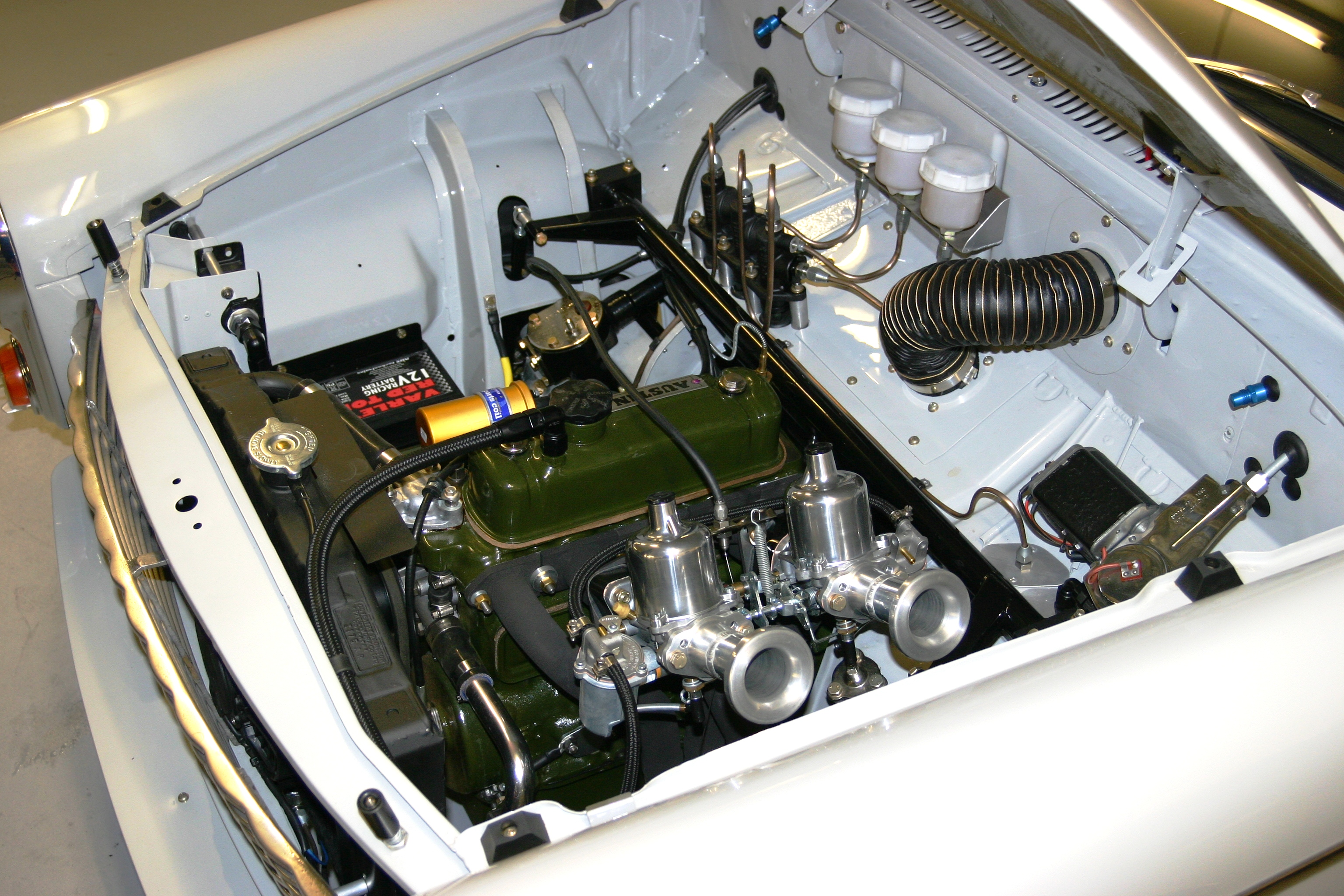

Car is lowered to min ride height for UK, very uprated front springs and custom built rears. Shocks have to be original bodies but we have two arms on the fronts. Front and back have adjustable valves and we can adjust bump and rebound. The front antiroll bar follows the original 1959 unit which is mounted across the front bulkhead just ahead of the master cylinders with link rods coming up from the lower spring pans through holes in the inner wings. This is very stiff and we have very little roll across the front. We also run full droop limiting.
