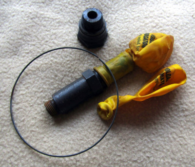

Post by Mike Hodgson » 24 May 2020 19:22
Any ideas ?

Post by Dave the rave » 24 May 2020 20:04
Compression tester ?

Post by Mike Hodgson » 24 May 2020 20:25
Close Dave,compression is involved

Post by Dave the rave » 24 May 2020 21:41
Hmmmm......deffo a spark plug fitting. Looks like 10mm and 14mm....... So......

Post by scotty » 25 May 2020 06:50
Balloon inflator without a doubt, there fitted in the picture.

Post by Mike Hodgson » 25 May 2020 09:09
The balloon inflation is part of the process .
Dave 14mm/18mm
The lid of the box

Post by Dave the rave » 25 May 2020 14:10
For a specific compression, the balloon is inflated to a specific size ? And that "ring" indicates the size ?
