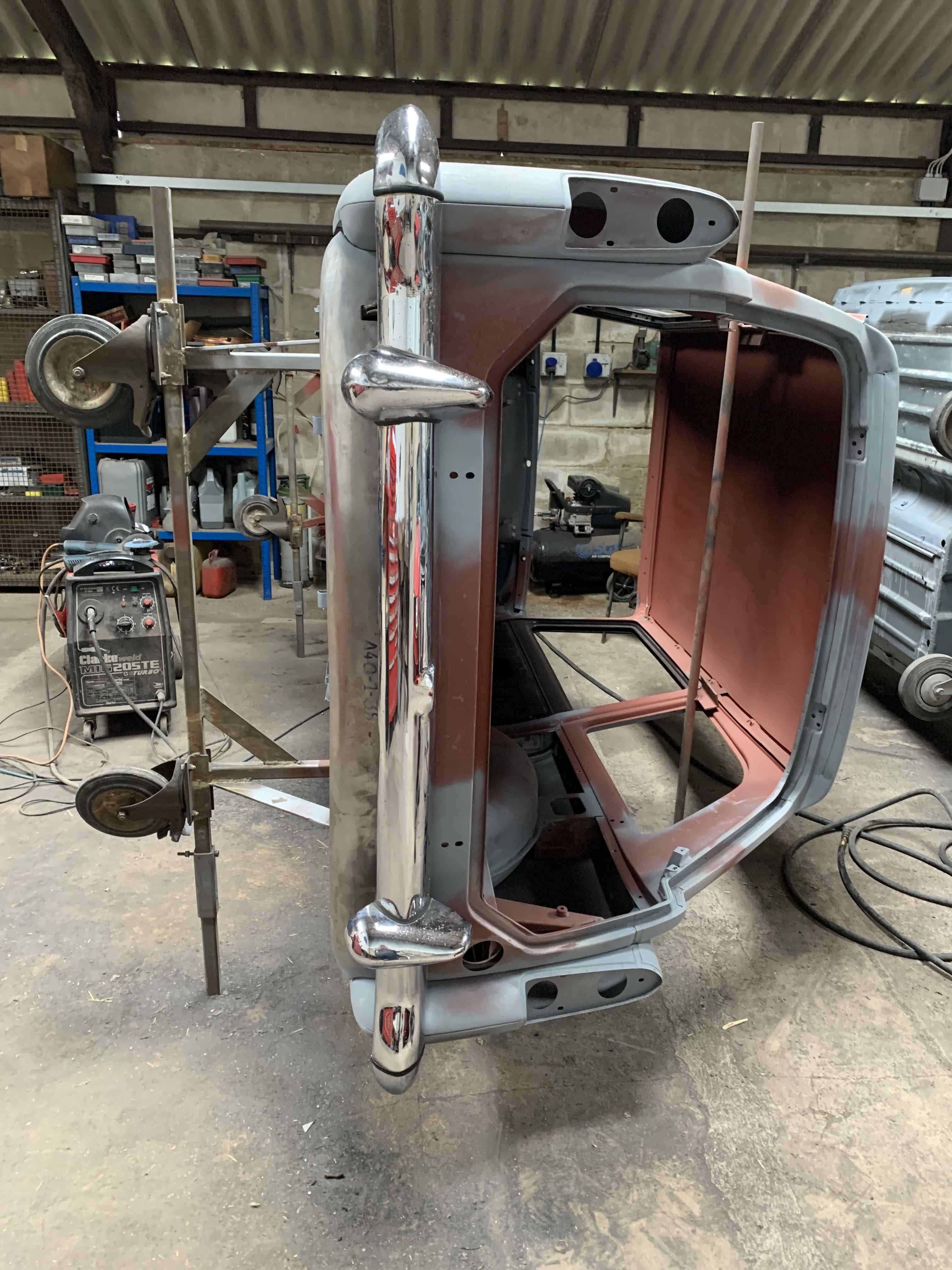

Latest update - just need to locate an o/s rear inner wheel housing panel as mine is shot! (You can see it on the car)
Am trying the usual channels to source a replacement but not a part the club remakes - but if anyone has a spare (!) please get in touch!

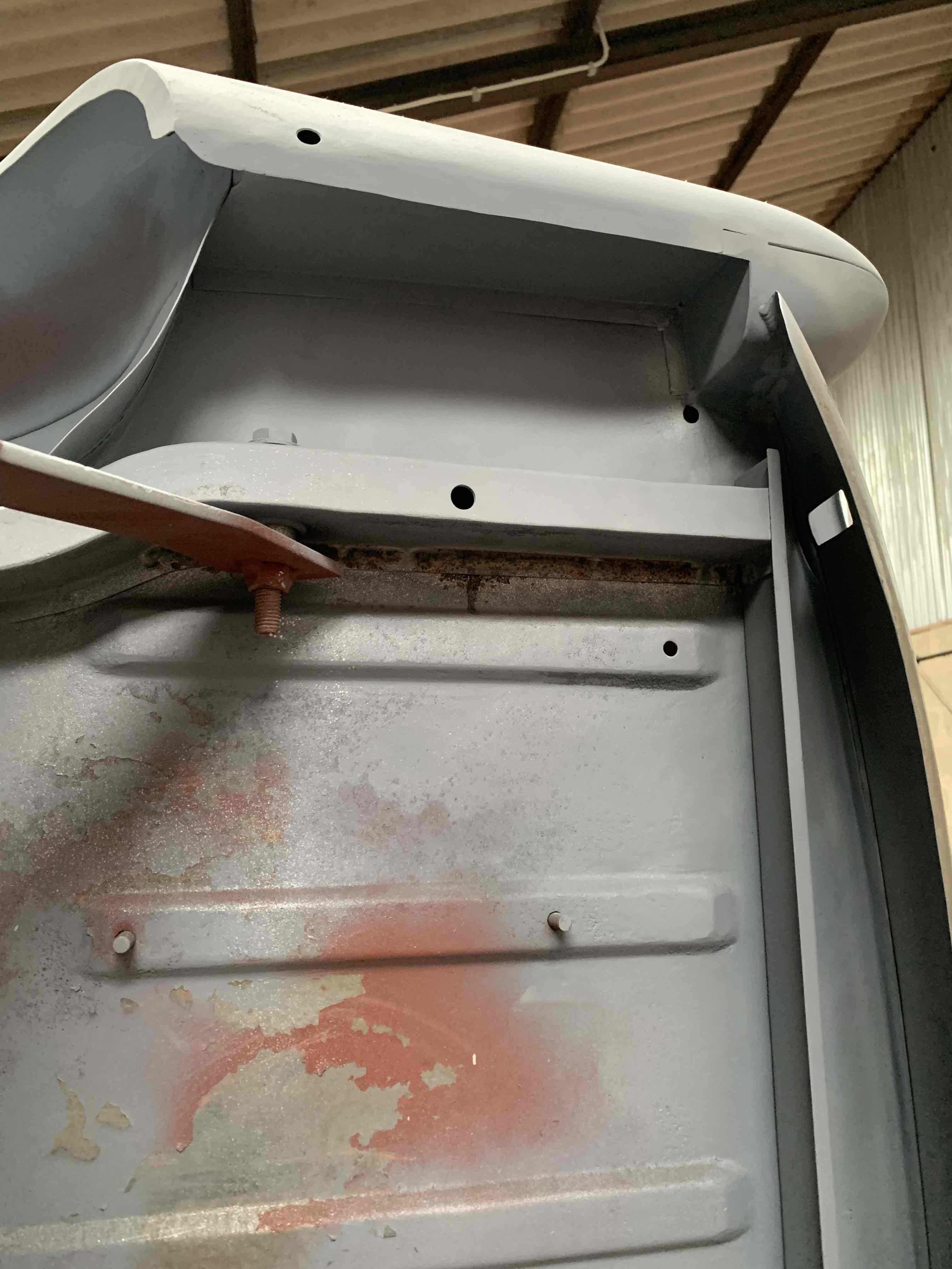

So a further update - new wings added and successful test fit of rear bumper - not long now until paint!

A word to the wise: that small hole which sits near the angle of the rear wing's closing panel is where the narrow rubber drain pipe from the base of the rear lights' unit emerges into fresh air.
The pipe is prone to being blocked by mud being thrown up by the rear wheel and, if not kept clear, will allow rainwater to rot out the light unit.
Worse still, if the pipe is perished or even missing entirely, the boot floor is in danger of rotting out so do take the time to ensure that it's doing its job.
Obviously the same warning applies to both sides of the car and I suppose the Mk2 shells have the same pipes.

Thankyou Keith - there were no drain pipes in situ so originals must have rotted away or were never fitted! They will be reinstated in the rebuild and and will be checked on a regular basis.
Now moving onto the rear boot / hatch repairs - if anyone has a NOS spare for a Countryman MK1 or MK2 lying around I would be delighted to hear from them!

Some final repairs to be undertaken to the boot and hatch but pleased that our car is going off to paint next week - Farina Grey all round as per original spec. Thanks to Derek at the club for some NOS hinges!
