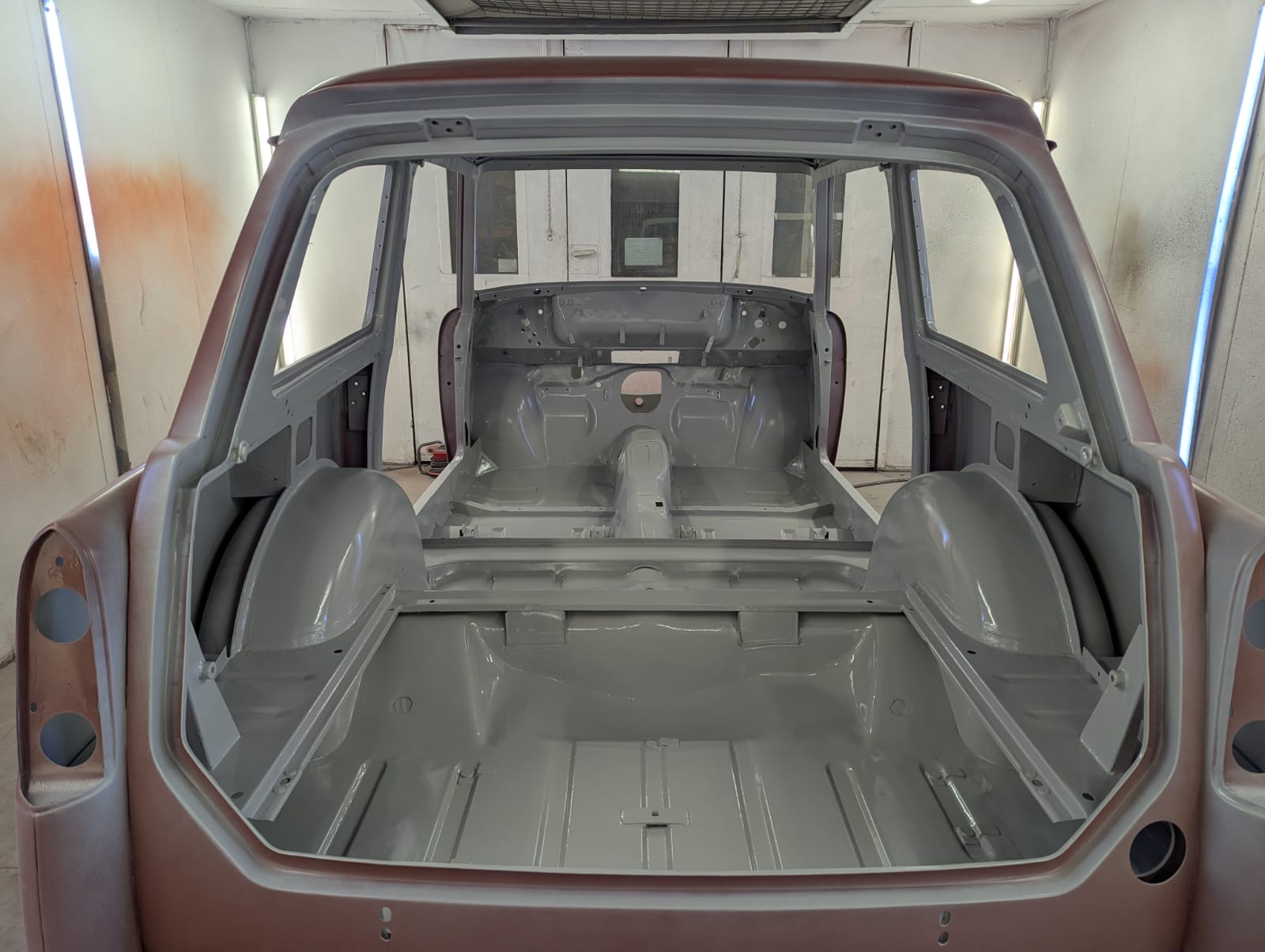

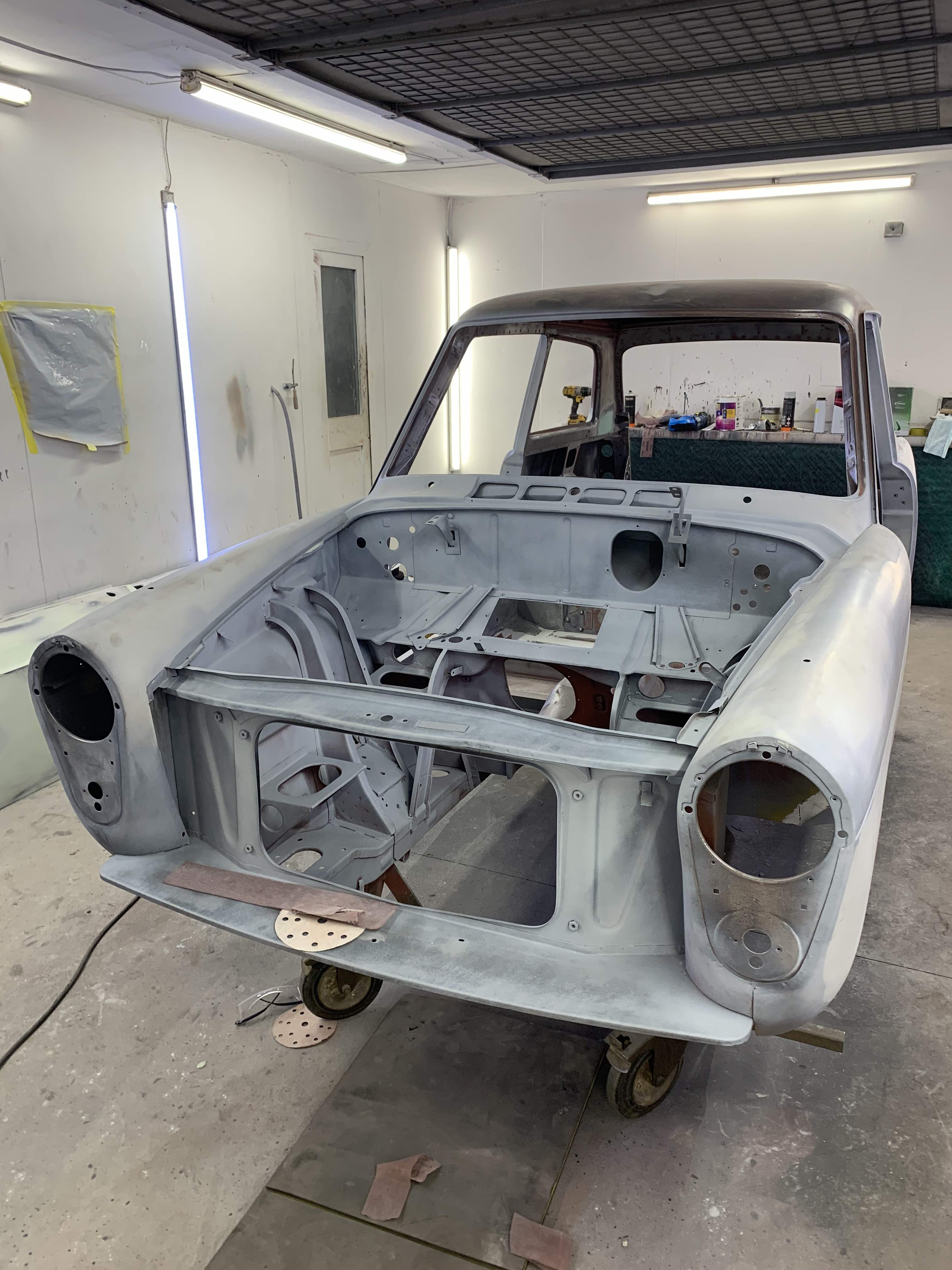

Post by Spiney4 » 15 Feb 2026 15:22

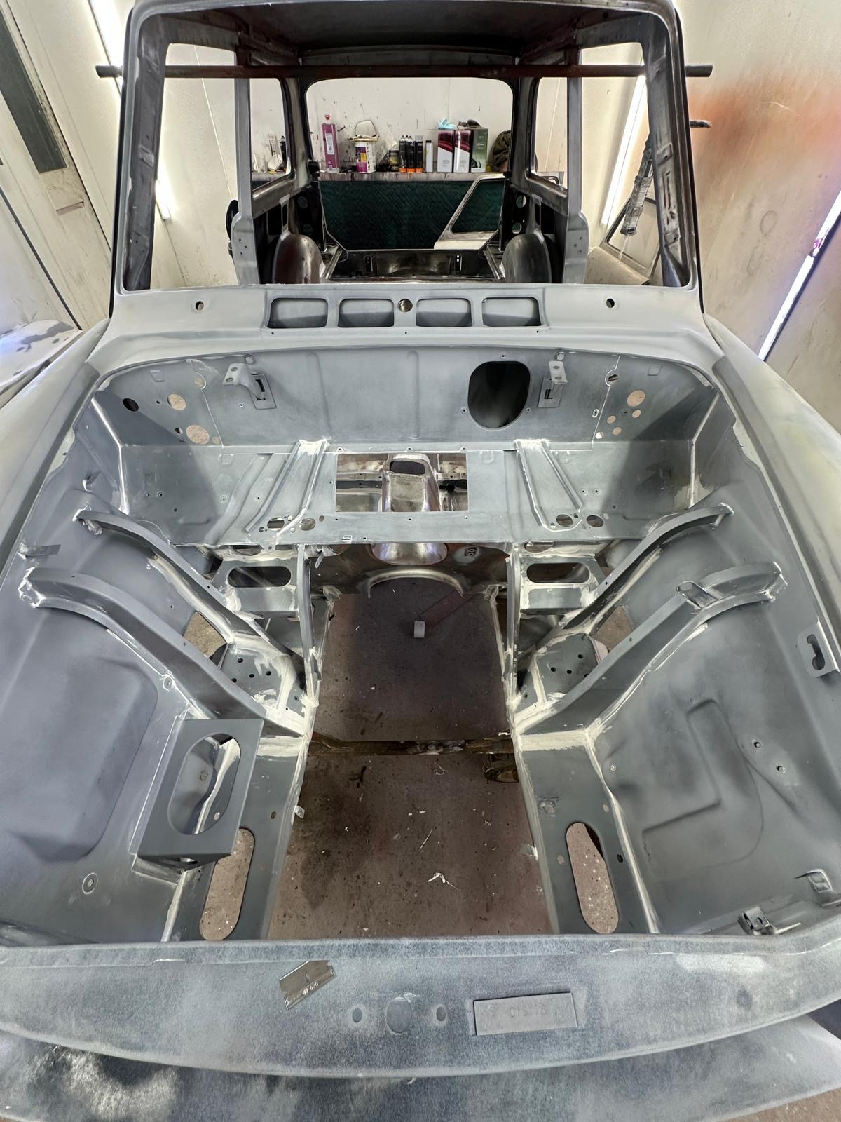

Nearly ready for first primer coat....
Posts: 1563
Re: New Garage Find - Suffolk
Post by Keith Bennett » 15 Feb 2026 20:41

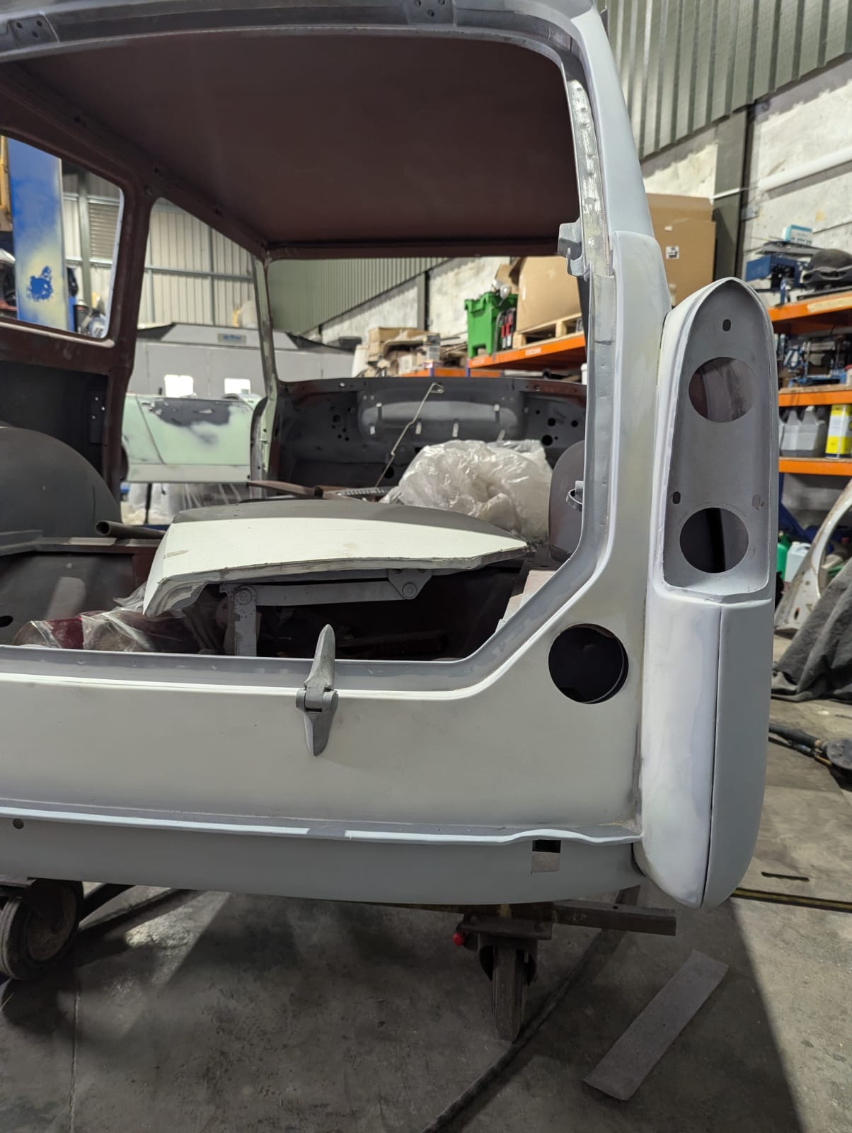

Looking very nice. Do check the bases of the rear light clusters have their drain hole clear - and don't forget to run the rubber tubes down to, and through the boot floor and into fresh air.

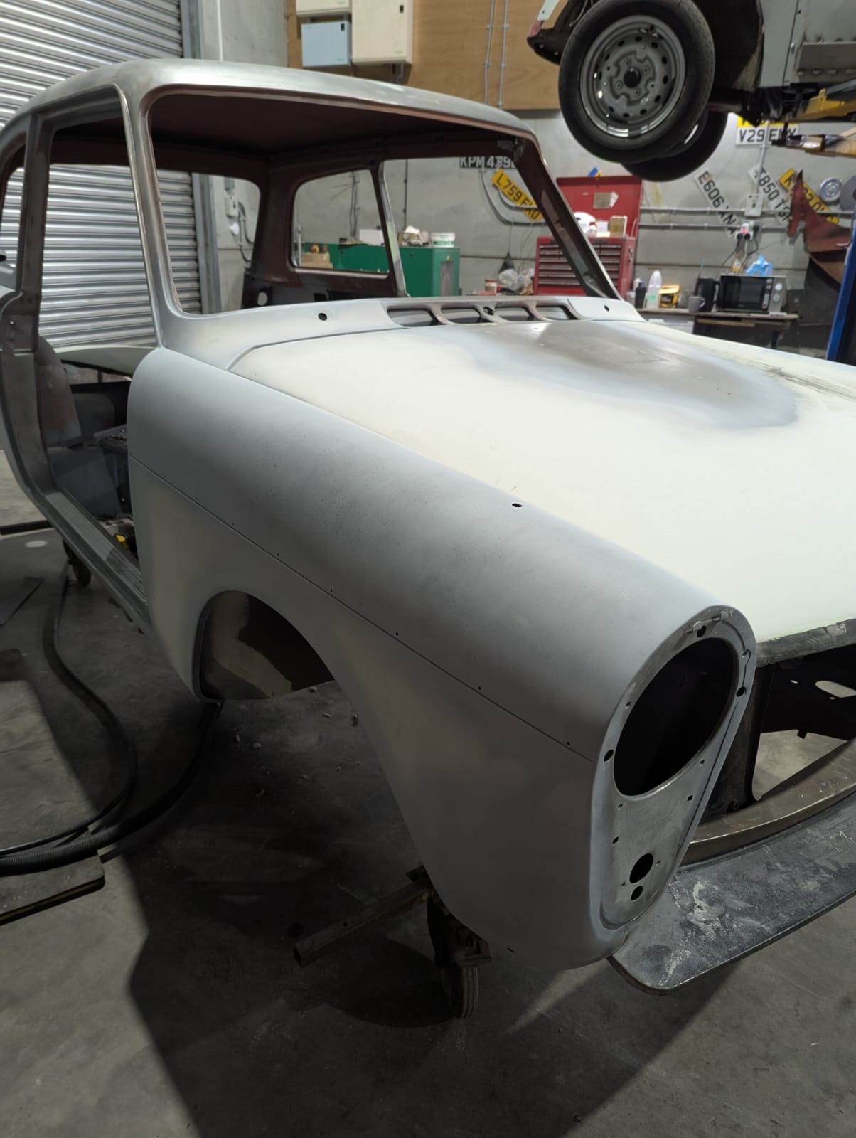

Post by Spiney4 » 22 Feb 2026 12:06

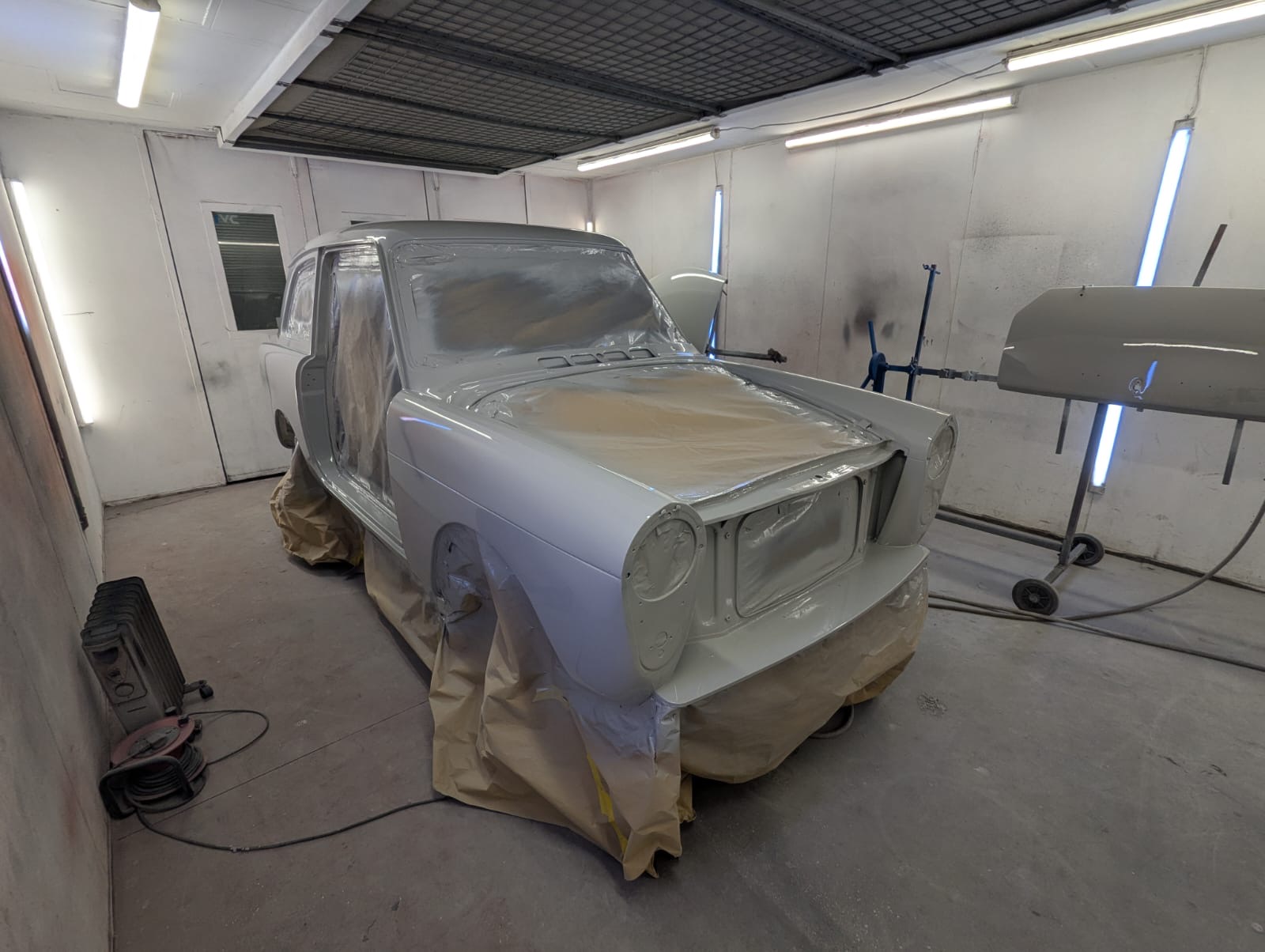

Finally in the paint booth!
Keith - drain holes all clear and tubes in the spares pile to be installed!

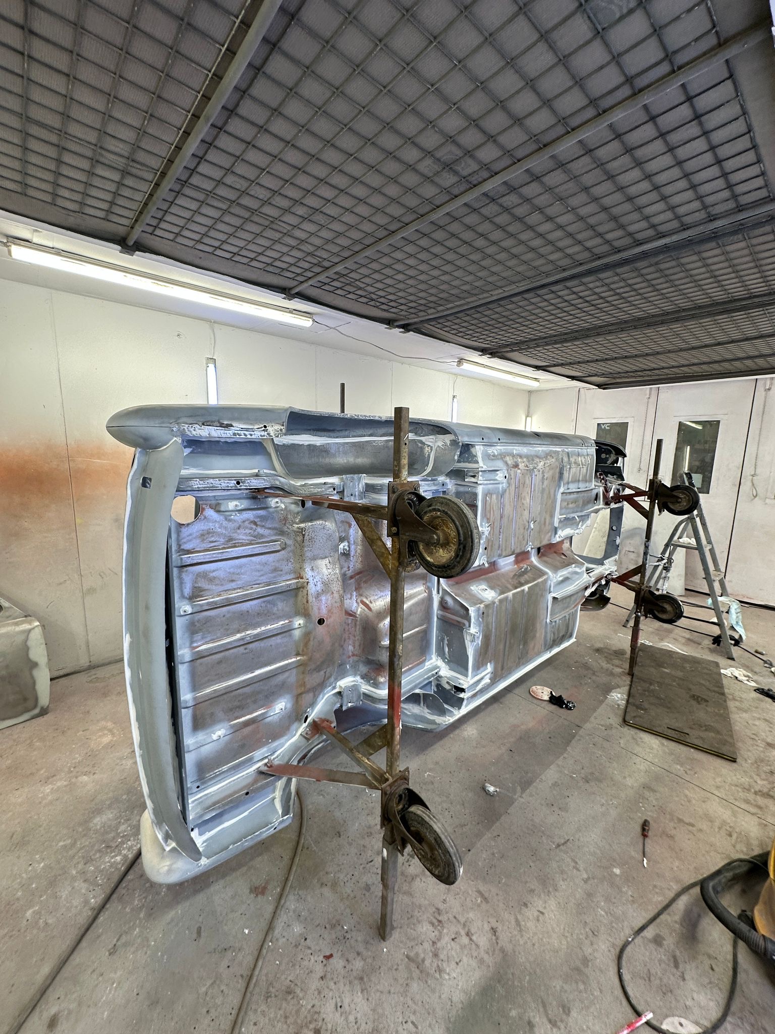

Post by Spiney4 » 25 Feb 2026 10:09

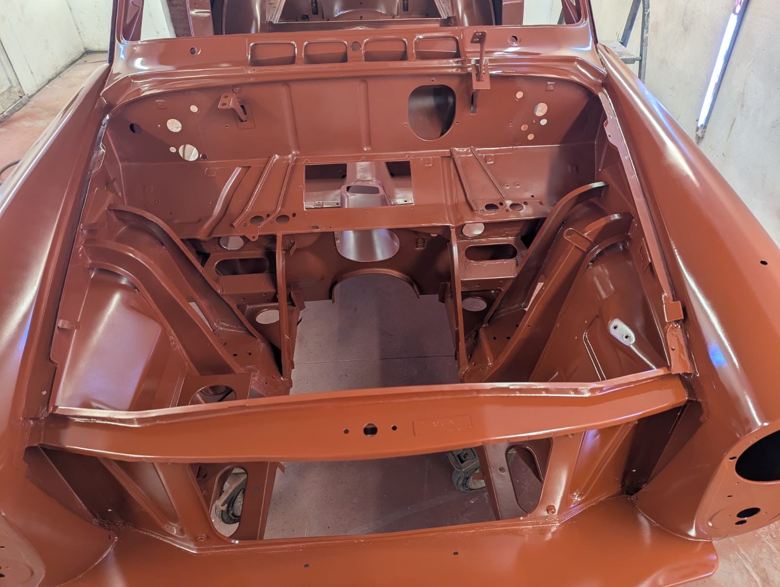

Underside seam sealed - next stop same in the engine bay and then non stop painting!

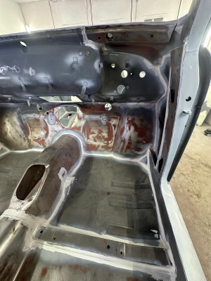

Post by Spiney4 » 28 Feb 2026 10:41

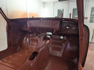

More progress - seam sealing completed and first epoxy primer coat.

Do I see steering rack mounts in there?

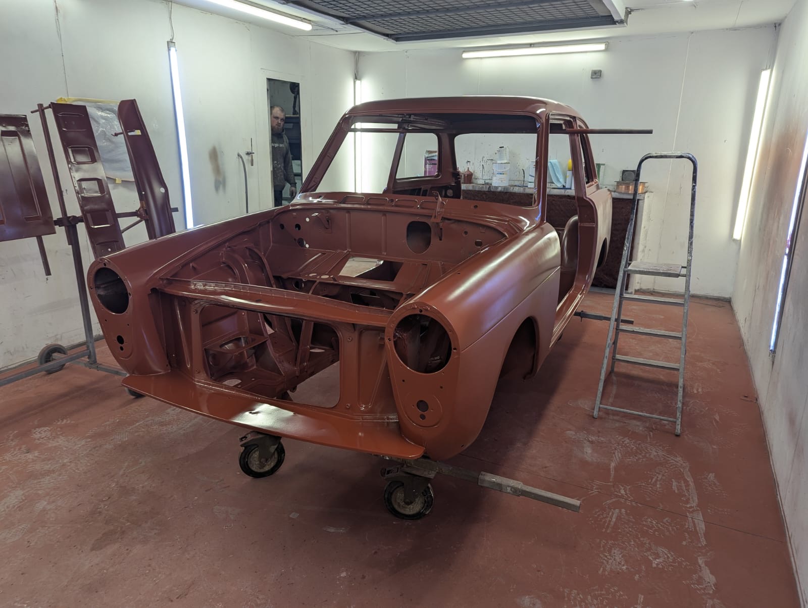

Spiney4
Posts: 39
Joined: 10 Mar 2023 21:54
Post by Spiney4 » 12 Mar 2026 11:01
Scotty - I hope nothing is missing as car is going to be a stock rebuild.
Painting is continuing!

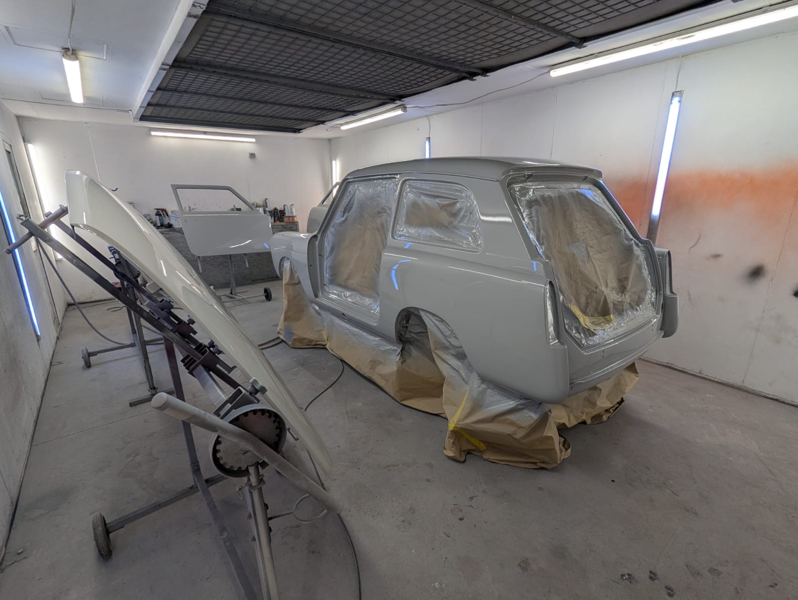

Post by Spiney4 » 10 Apr 2026 11:33
Top Coat (farina grey) at last!
