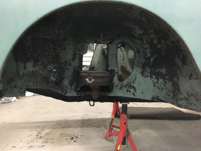

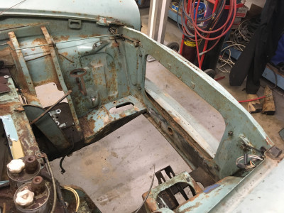

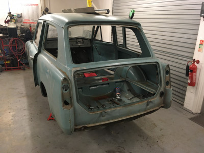

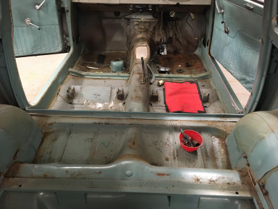

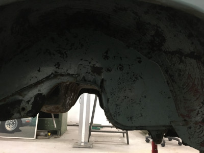

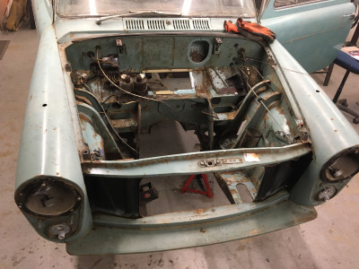

Stripping has started to get ready for a serious clean of the shell. This is a very solid body, virtually all the rust stains are surface only, once worked with wire wheel, wire brush and buffing mop, things will look very different.

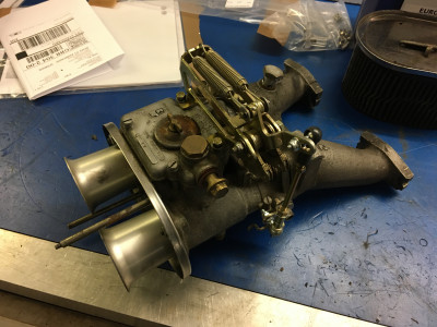

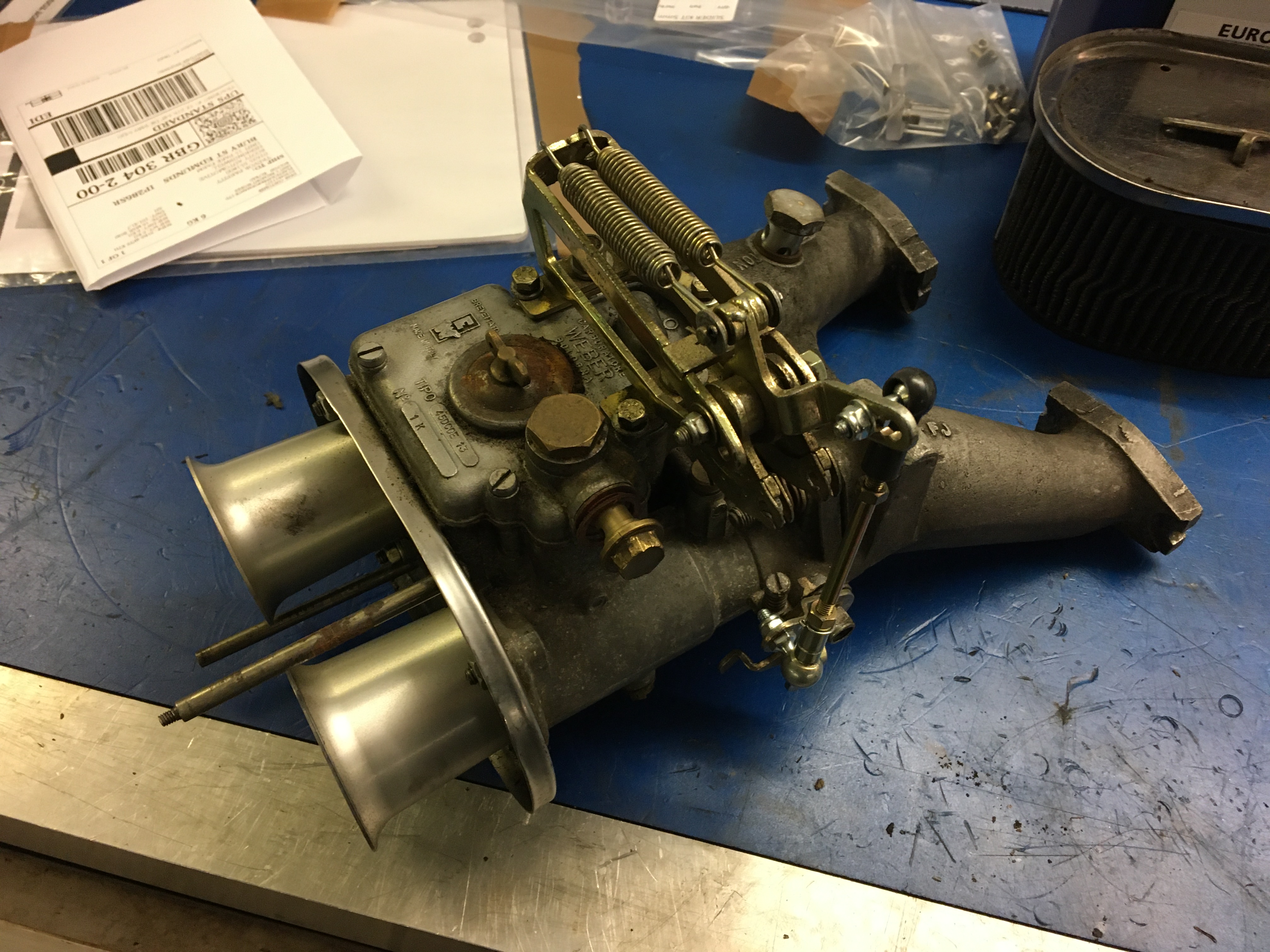

....and look what Simon found on line, this full Formula Junior 45 DCOE Webber might just find a place in the engine bay once stripped, cleaned and rebuilt.

hi trevor , so thats the one you spoke about, looks really good, you going to put the weller wheels on it as they really suited doc's car,
keep us posted ;)
