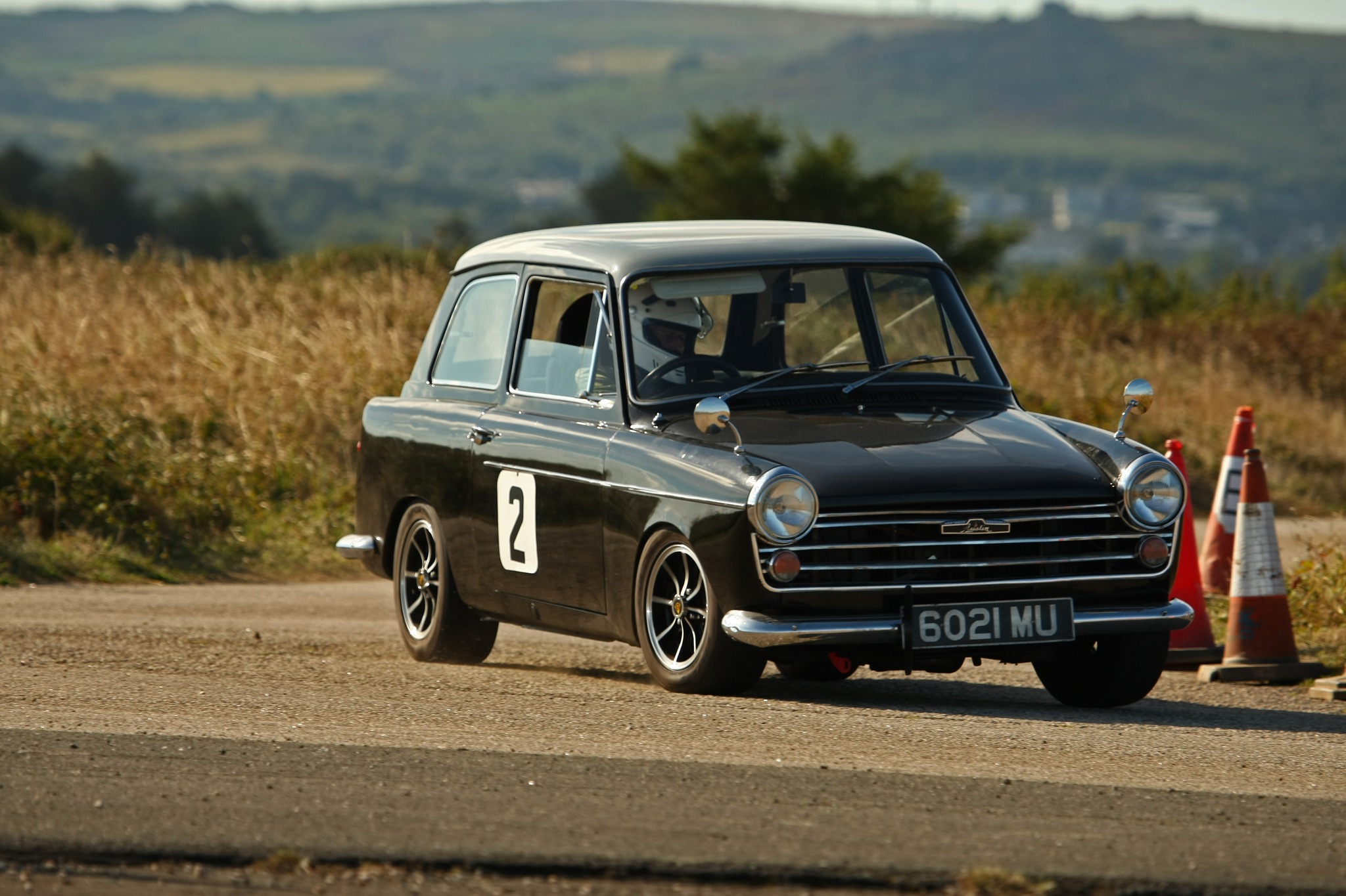

Post by 190251cars » 31 Aug 2022 15:41
Well since my last outing in the car I have lowered it another inch at the front and changed the diff.ratio,
it's now a 4.55-1 and made a fantastic difference.
2 day event (Sprint) at Portreath in Cornwall and came home with a first in class on Saturday and repeated again on the Sunday.

Re: Tyre Size
Post by Keith Bennett » 31 Aug 2022 16:50
Warmest congratulations on the wins - and we're glad our website was of some use!

Post by scotty » 31 Aug 2022 20:57
Well done, looks like you could now lower the back at least the same, this should also help a lot. Stiffer front anti roll bar would help, possibly stronger front springs, but only one thing at a time, then you know what works and what doesn’t, also how the differences feel.

Post by 190251cars » 01 Sep 2022 07:28
Thanks Scotty, New lowering blocks for the rear arrived yesterday so that is the next job. I'm loving this car and I am surprised how well it handles even now.
Wiscombe this weekend and next Saturday, watch this space!
