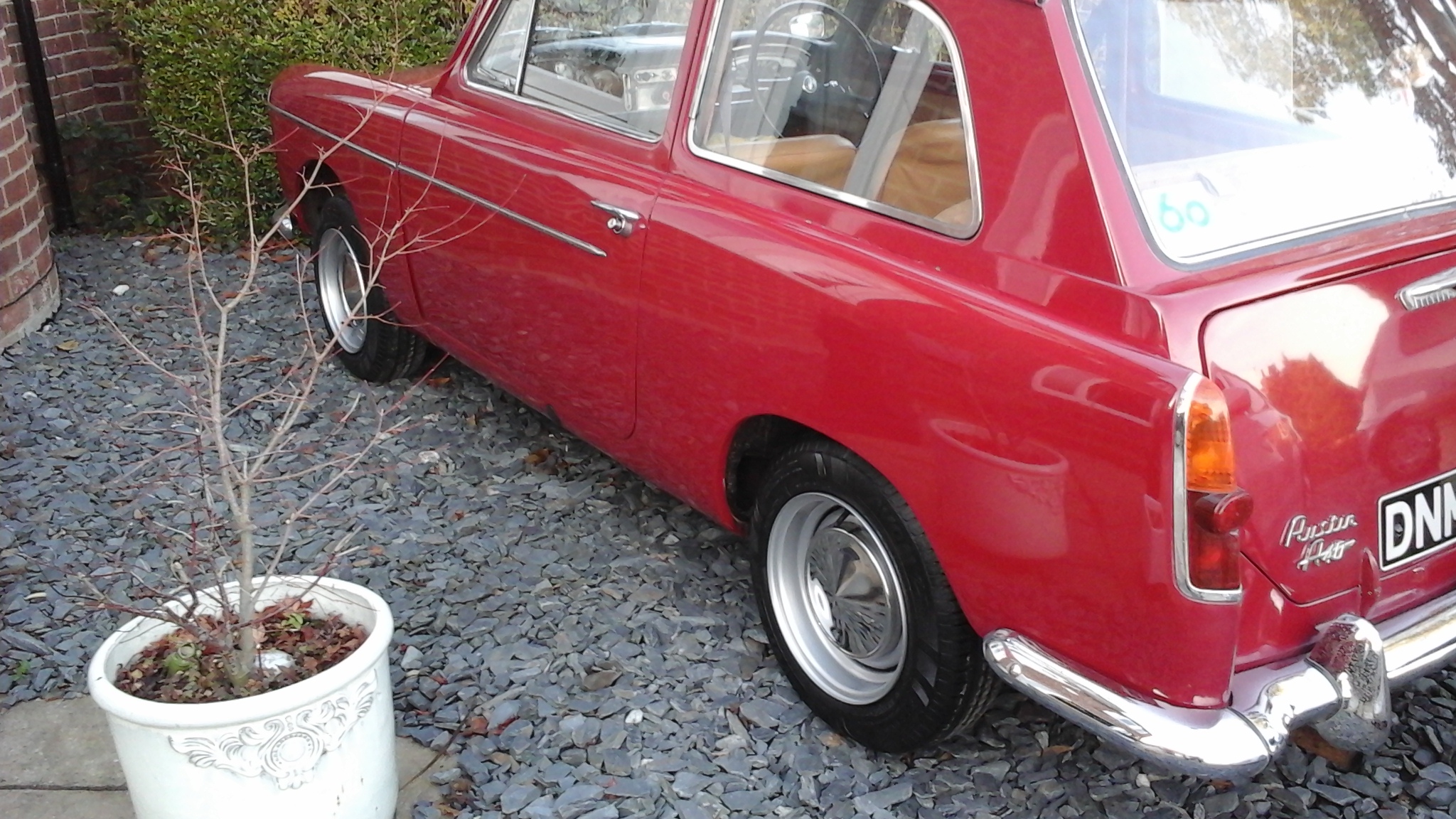

Well, I managed to squeeze on a set of Dunlop D1 replicas (5.5 inch) with 185/60 x 13 Nankang AR-1 tyres.
My only issue was tyres rubbing on the lip of the front wings until I fitted negative camber top trunnions.
Next job is to change the back axle ratio to something lower.
