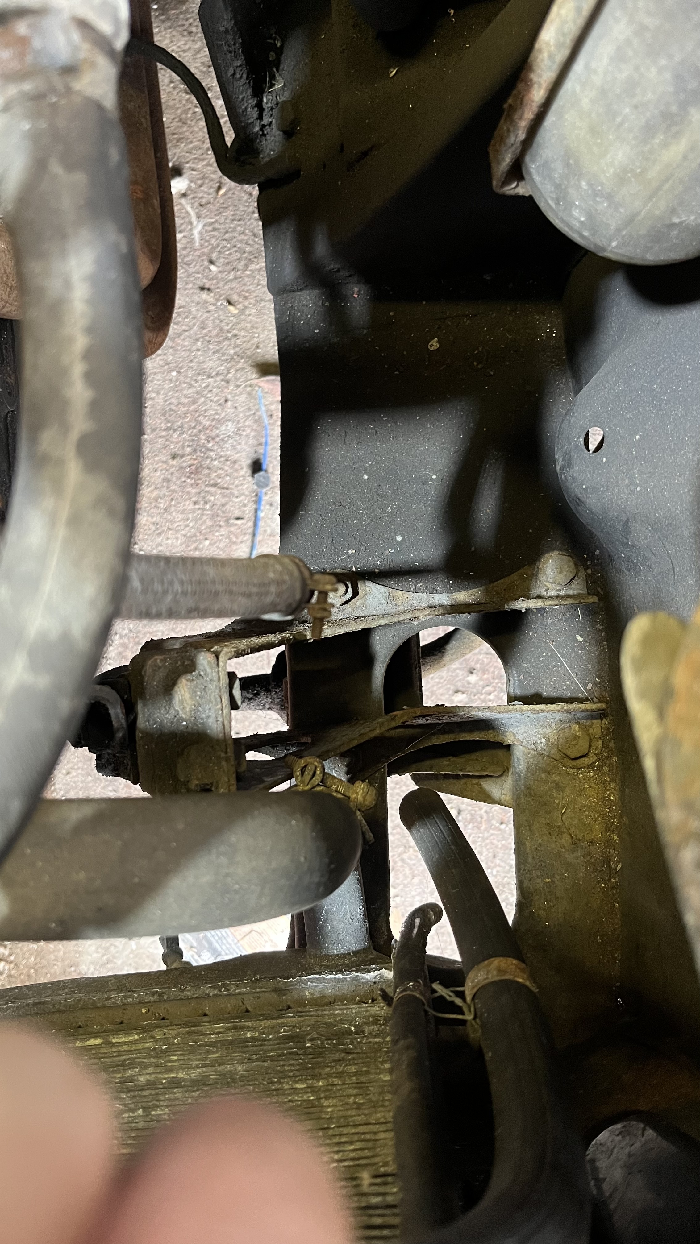

So hasn’t gone to plan this weekend with the rain, so I couldn’t roll her and get the measurements
But I did manage to have a little look around
A worrying sign to me was the passenger side engine mount is bent so I’m thinking maybe there is more damage then just then I thought
