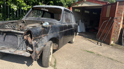

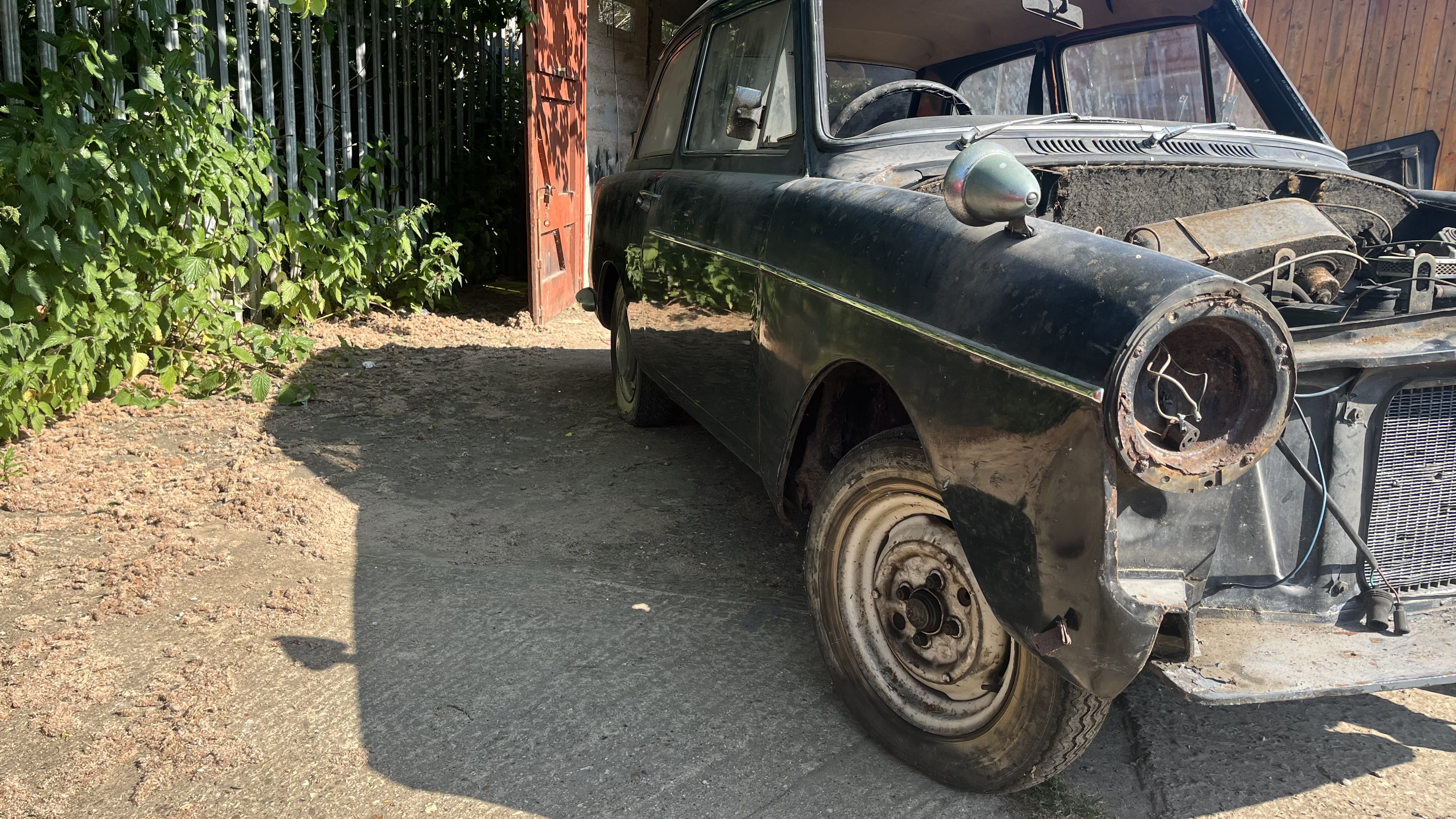

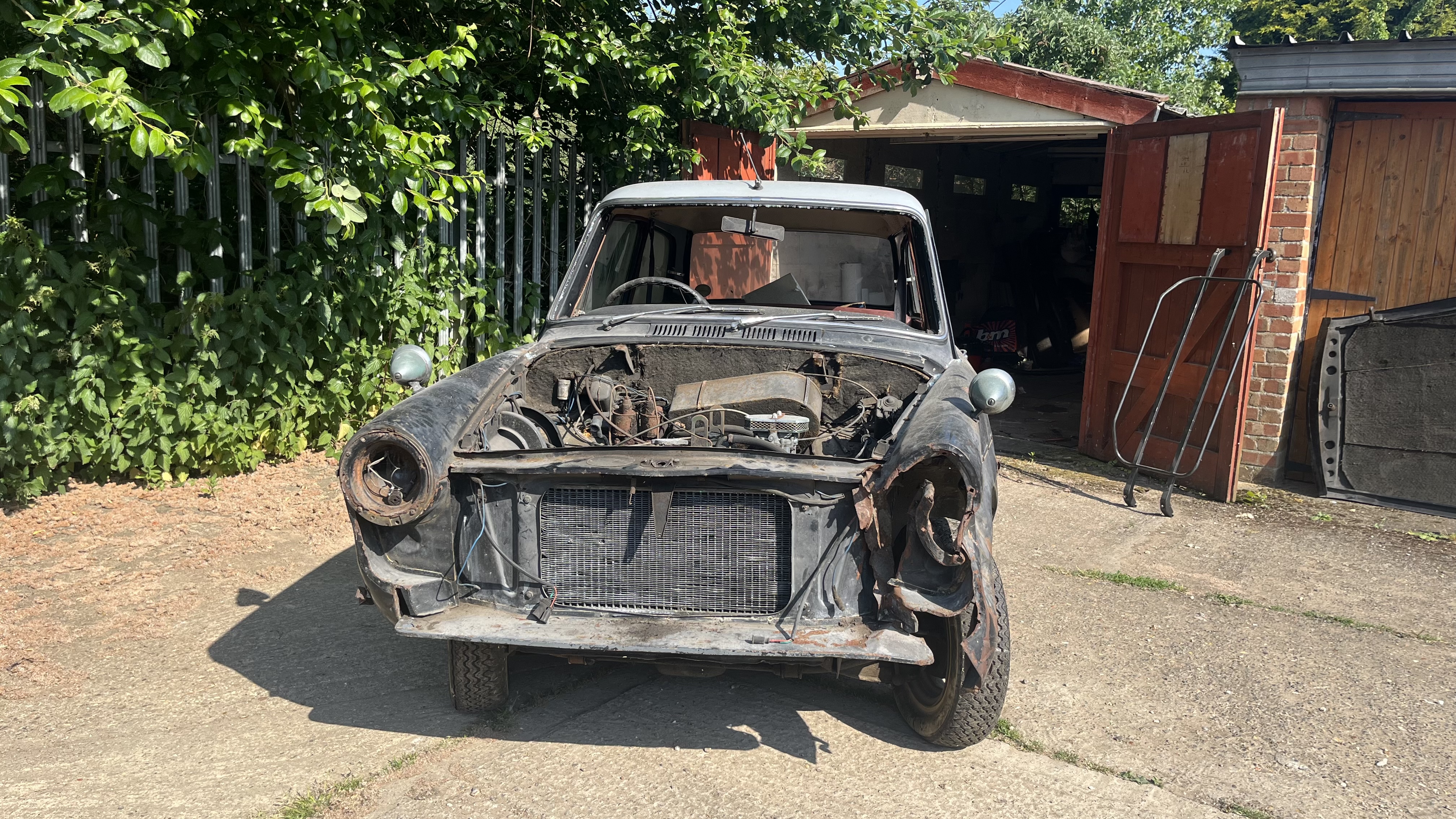

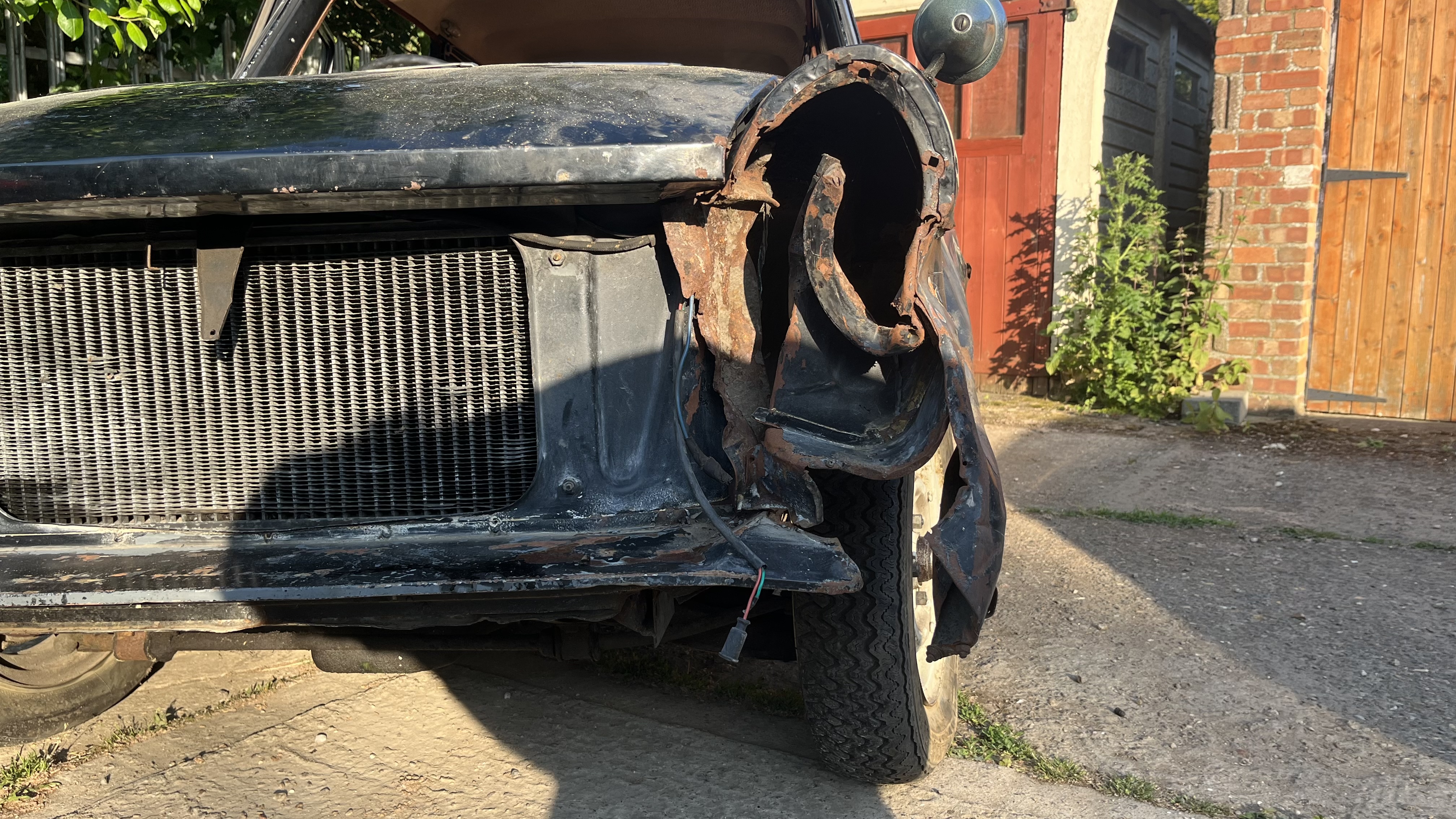

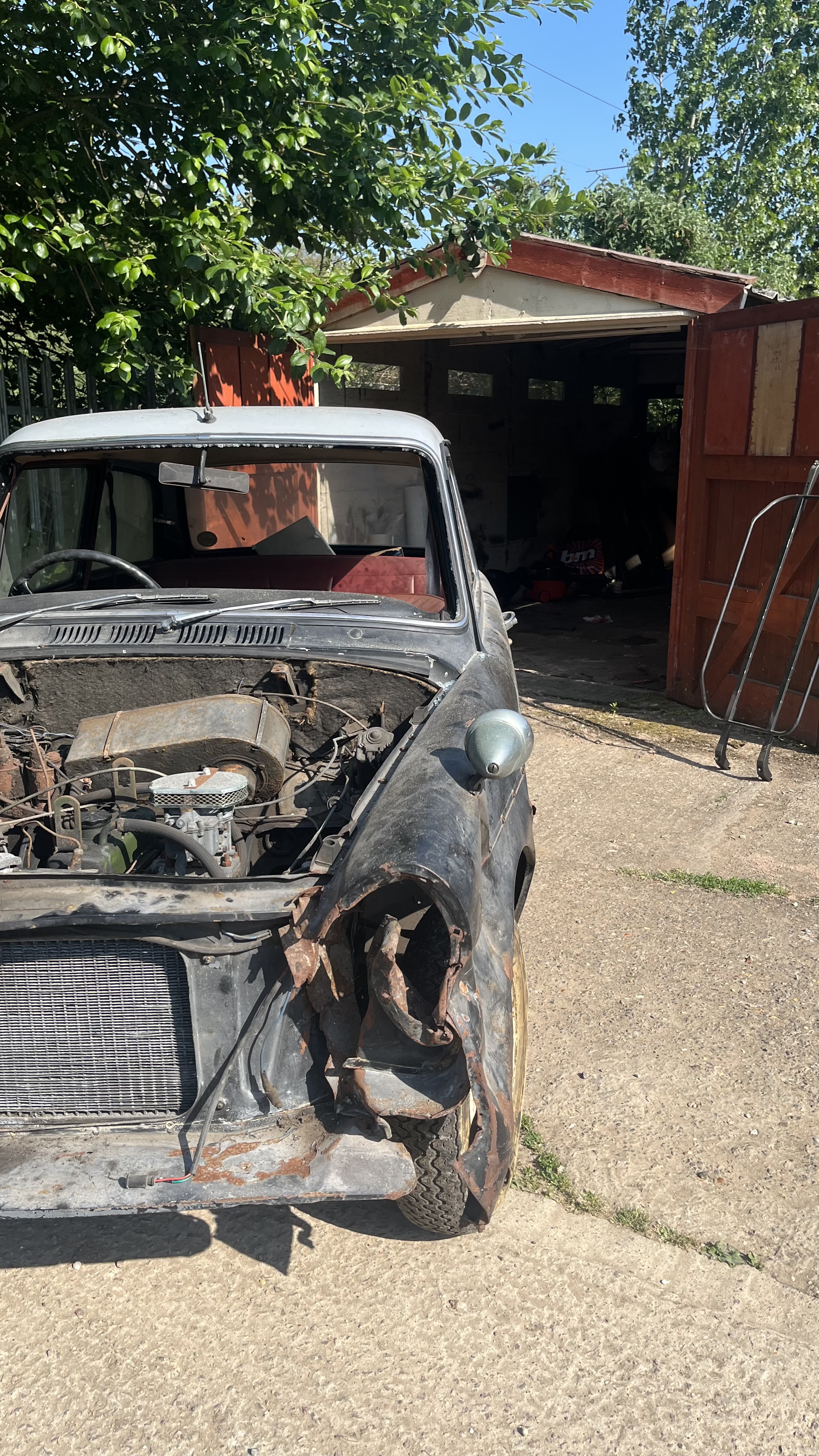

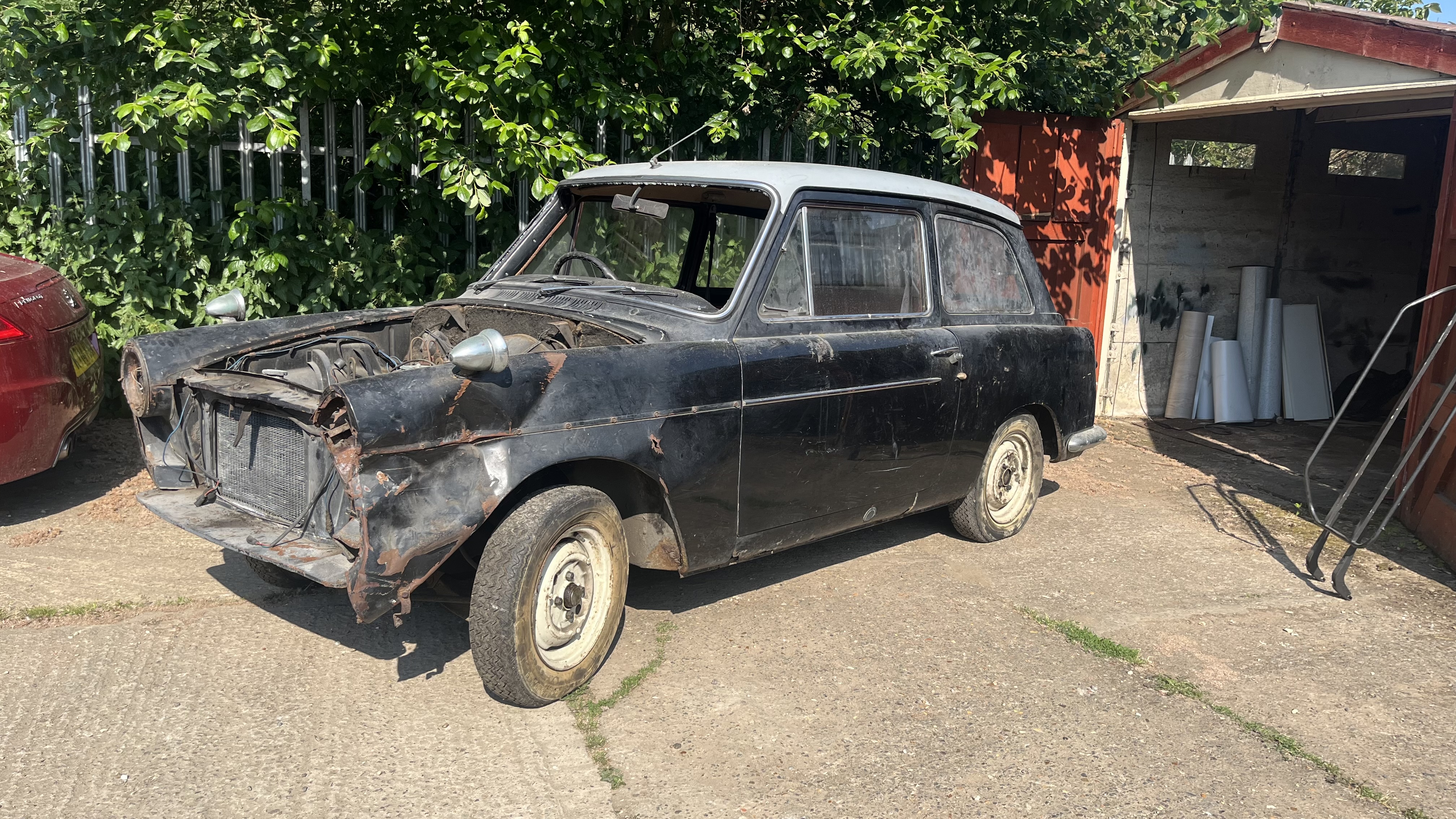

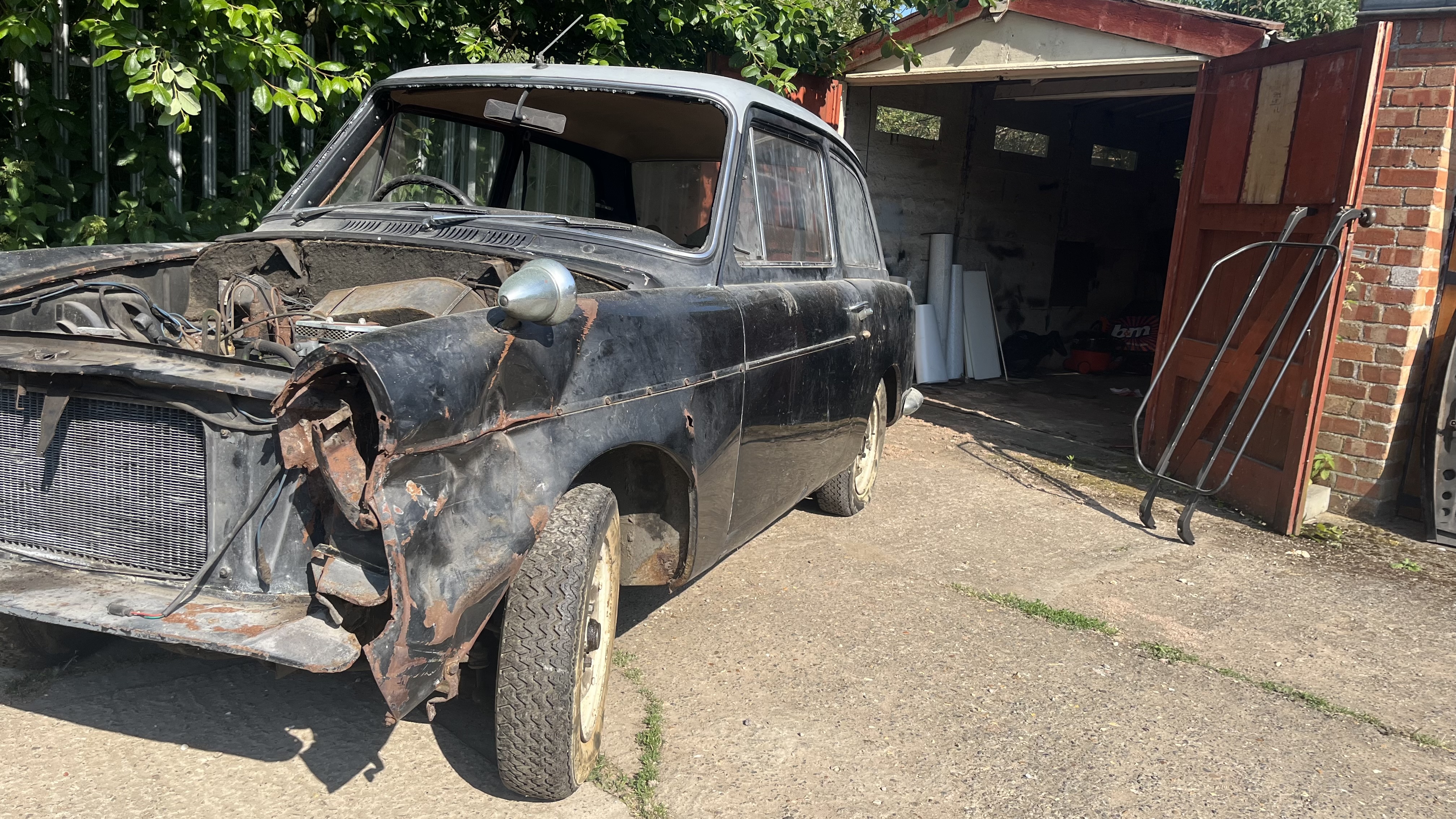

If there’s an angle or particular part you all need to see let me know
Do you think it’s possible to get running again?

I’ve had a good look around (with very novice eyes)
The problem area is obviously the front and having a look at what I believe is the ‘half chassis’ at the front they don’t seem to be bent. Just the shell is in bad shape to say the least

Chris Ennis is the best man to ask. Definitely worth doing though

Re: Advice Needed
Very repairable.
If you decide to repair/restore you will have all the help club members can give .
It would be wise to check the condition of the rest of the body, don't worry re mechanical items they are an easy fix
check condition of floor panels, rear chassis leg around spring hangers ,rear wings (under bumpers),corners of bulkhead (under bonnet)
inner and outer sills .
