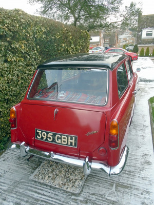

Bar and I live at the top of a steep hill and are doing our best to self-isolate but every month we need to do a big Morrison's shop to stock up. With more snow forecast we thought we'd go this morning - very little snow around but boy, very slippery under foot and cross plies!
Gab sedately slid down Wood End but happily the main road was clear, so all good. Hardly any cars around (the downside of course is that our road is lined with dozens of parked cars cos folk seem incapable of parking on their driveways).
Haven't driven her for a few weeks and what struck me most was the small size of the pedals. You'd think after 55 year's ownership I'd be used to them by now...
Safely home and unloaded ready to be tucked back up in her garage.
