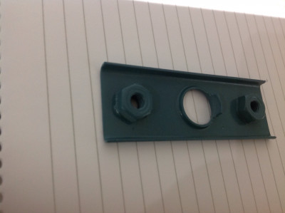

I have dismantled the bonnet catch mechanism that is attached to the underside of the slam panel in order to clean it in the hope that it will operate more effectively , it had been sticking.
I have attached a photo of one of the plates that sits under the slam panel. The photo has been taken of this sitting upside down so that you can see the lug that is on the right hand side of the hole in the centre of the plate.
My question is when attached to the car does this lug sit to the right or left hand side of the car as you look at it from the front?

Viewing from the front, lug to your left

Thanks Mike
