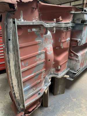

Been to look at the car today - now onto the back starting with the spring hangers that are past their best!

Thanks Keith - will bear that in mind. Car rear floor is now being worked on - Chassis legs need a fair bit of new fabrication as the originals were rather open to the elements so have rotted out or metal has blown. New Spring hangers have also been fabricated as unfortunately sourcing an A35 pair didn't resolve matters.

Latest update - significant repairs needed to the chassis legs and rear floor - been strengthened and rebuilt with some donor parts - very fiddly, time consuming and an expensive job! Next job is the inner and outer rear wings!
