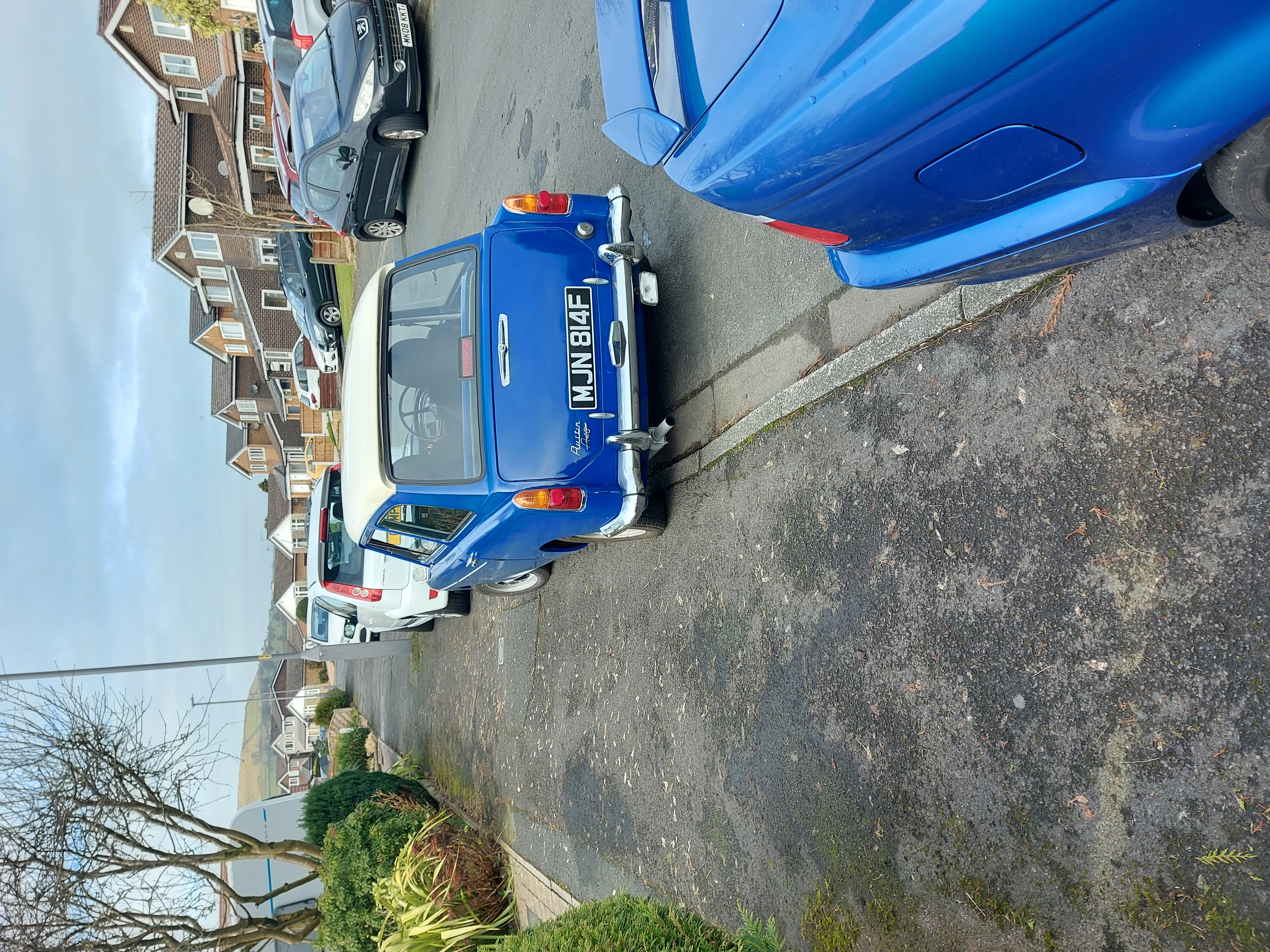

This is my A40 by the way. My Dad is (was) a mechanical fitter as am I. My uncle is still a mechanic and they brought me up obsessed with old tin. I've never been able to have my own till now. It's bloody brilliant.

And on it side for some reason :lol:

Car looks lovely, even in an unoriginal colour, but well suited to it, as is BRG too. And for once, I love the Midget ro-style wheels on A40s. ( As a rule, I despise different wheels on classics.....).
Oh, click on pic and it's right way up......don't ask me why that should be so......
