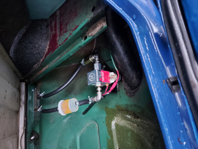

New member and new owner! I've a late mk2 1098. The engines only about 100 miles run in after a rebuild by the previous owner. It has a 295 spec head, a minisport inlet manifold, pancake air filter and a 3 branch tubular exhaust manifold with a 2" approx exhaust. Otherwise stock (well apart from an alternator conversion and accuspark ignition). The car starts on the button and idles well but on the move it can hesitate and pop back through the carb. Even when it runs well under load it always feels like it's holding its best back.
Fuel starvation I thought. So today I've replaced the SU type electric fuel pump with a Facit solid state fuel pump and installed an inline filter to keep an eye on things. The end result? The bloody same! The car is being run on 99 octane. Next job is to recipe the car along it's length as its on 6mm copper at the minute to just before the carb which seems a bit small to me. So I'll redo it in 8mm. If the same problem persists then I'm at the carb.
What do you think? I'm new to pre 1980 cars and if anyone thinks I'm barking up the wrong tree any guidance would be much appreciated :D

Hesitation and popping back would lead me to check the ignition timing and the vacuum advance/retard first. Its a modded engine so might want slightly different to the spec. Also the plugs - are they correct and not too hot/cold rated?

Might the carb need a slightly different needle ?

Brilliant, thanks for that. I'm going away for the next few days but on Friday me and Uncle are getting it on the timing lamp so I'll check the plugs while I'm at it. Any recommendations on plug types?

Thanks Dave. Uncle did mention that a different needle might need to be tried. We'll get there, bit by bit :)
